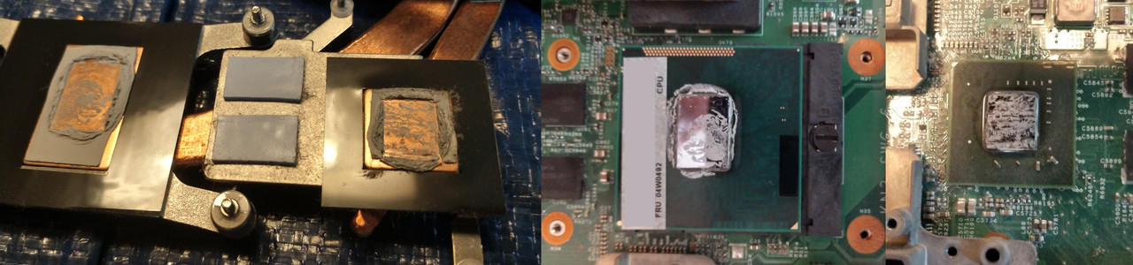

After replacing my T520's original i5-2520M with an i7-2760QM, the NVS 4200M is now behaving correctly again. No more crapping out, no matter how hard I try to reproduce that symptom. Since I changed two variables (replacement processor + different model of processor), it is impossible to say with 100% certainty what the exact problem was. But I can at least conclude that either one or both of the helpful diagnoses from TPFanatic and RealBlackStuff were correct.
I was a little surprised when I removed the cooler assembly to get to the CPU. Either the refurbisher shelled out extra money for a cooler assembly FRU with machine pre-applied paste, or much more likely my T520 was still rocking the very first paste it got from the factory in 2011. To my amateur eye, it looked like the vast majority of the paste that was once in the interface area had been pumped out to the sides over the years.
https://i.postimg.cc/hPv9XW8K/paste-on-all.jpg
FORUM warning:
picture(s) WAY too big, tags removed. Please read the Forum Rules, especially Section 5: https://forum.thinkpads.com/viewtopic.php?f=16&t=14339
The new gelic gc extreme paste I applied is working well. Now that it has had a few days to fully cure, the 4200M sits in the 150-152°F range at 98% utilization. Way better than the 180-183°F at 75% utilization I was getting before. I wonder how the gelid paste compares to whatever paste the Lenovo factories used (circa 2011) and how long the gelid would take to get the state shown in the photo above. But I certainly won't let it sit for another 12 years before getting refreshed.
