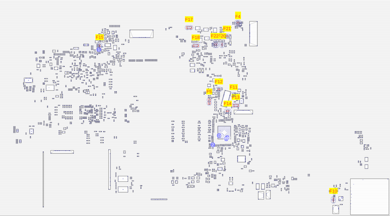

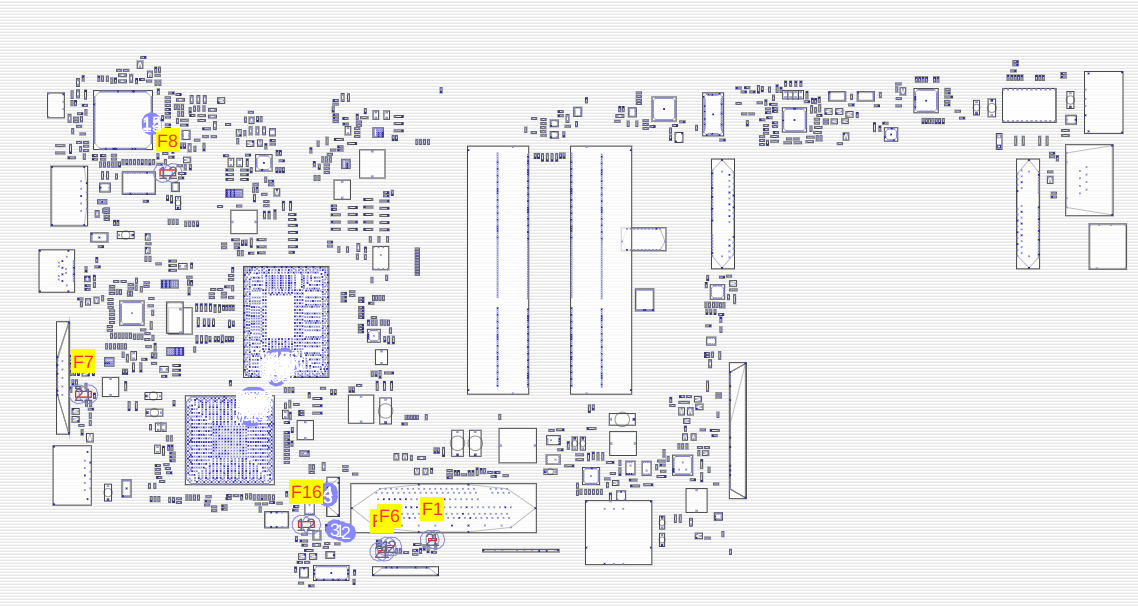

There are multiple fuses on the motherboard. If the PSU is faulty it could have damaged the motherboard but you wont know without another charger. You can look for fuses on the motherboard and check them with a meter, they should of course measure 0 ohm (or beep with the continuity beeper) if they are OK. Fuses are marked e.g. F1, F2, F3 ... The X230 schematics are available here viewtopic.php?p=822767 if you want to check which fuses do what. And there are boardviews also in that zip which show where the fuses are, I've taken some screenshots of the top and bottom fuses for you which may help:
