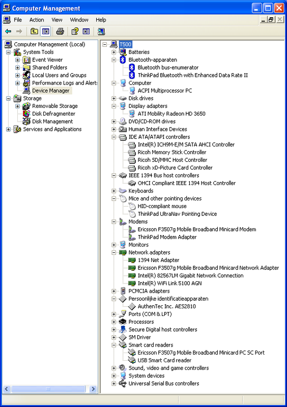

I installed XP x64 SP2 on a T500.
I read that I should have pressed F6 to install the AHCI drivers. Can I still install these drivers or do I have to reinstall XP?
I tried 13-1-legacy_xp64_dd_ccc_whql.exe for the Radeon HD 3650 and I have the correct screen resolution and hardware acceleration even though it complained that I don't have .NET 3.0.
I tried 6ea303ww.exe for the Conexant Audio chip, because I had read here that it would work because the W700 has the same chip. It works.

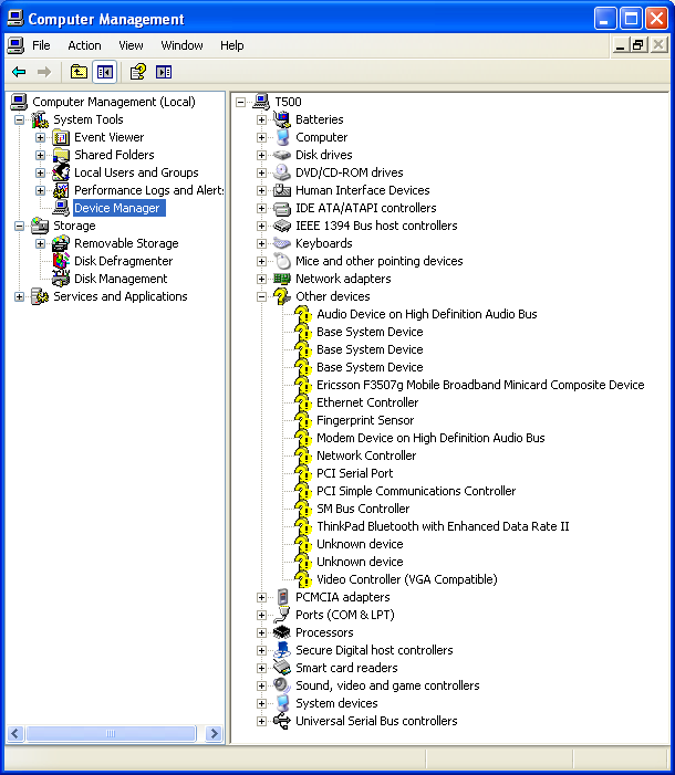

Now I have 13 missing drivers. I wonder whether I will find 64-bit drivers for all these things or could it work with a 32-bit driver.
The same devices in the same order:
PCI\VEN_1180&DEV_0592&SUBSYS_20CA17AA&REV_11\4&8365E1C&0&04F0
PCI\VEN_1180&DEV_0843&SUBSYS_20C917AA&REV_11\4&8365E1C&0&03F0
PCI\VEN_1180&DEV_0852&SUBSYS_20CB17AA&REV_11\4&8365E1C&0&05F0
USB\VID_0BDB&PID_1900\3541430233863600
PCI\VEN_8086&DEV_10F5&SUBSYS_20EE17AA&REV_03\3&B1BFB68&0&C8
USB\VID_08FF&PID_2810\5&2FF31994&0&1
HDAUDIO\FUNC_02&VEN_14F1&DEV_2C06&SUBSYS_17AA2122&REV_1000\4&2B9C4D19&0&0102
PCI\VEN_8086&DEV_4237&SUBSYS_12118086&REV_00\4&318470AD&0&00E1
PCI\VEN_8086&DEV_2A47&SUBSYS_20EC17AA&REV_07\3&B1BFB68&0&1B
PCI\VEN_8086&DEV_2A44&SUBSYS_20E617AA&REV_07\3&B1BFB68&0&18
PCI\VEN_8086&DEV_2930&SUBSYS_20F917AA&REV_03\3&B1BFB68&0&FB ACPI\IBM0068\5&2890D699&0
ACPI\INTC0102\1
Posts: 4413
Re: T500 with XP x64
#2 Post by axur-delmeria » Thu Dec 16, 2021 12:08 pm
Any PCI device that starts with VEN_8086 is Intel.
DEV_10F5 is the Intel 82567LM gigabit LAN
DEV_4237 is the WiFi 5100
DEV_2A47 and 2A44 are parts of Active Management Technology
DEV_2930 is probably the SMBus controller
The VEN_1180 ones are the Ricoh card reader, Cardbus, and Firewire devices.
The HDAUDIO one is the Conexant dialup modem.
ACPI\IBM0068\ is the Thinkpad's Power Management controller.
As for drivers, try the Vista x64 ones. 32-bit drivers will definitely not work.

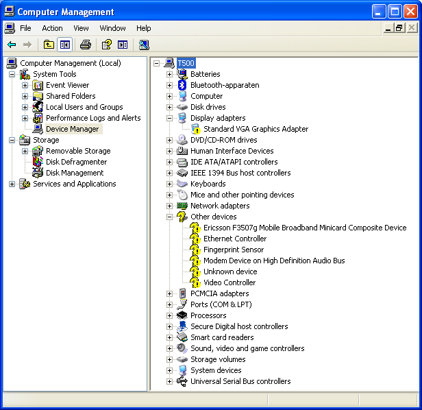

#7 Post by OS923 » Wed Dec 29, 2021 12:24 pm
7kss73ww.exe installs the multi-card reader, but you have to point the new hardware wizard 3 times to the correct folder.
I enabled everything in the BIOS and started over.
First I tried to install the built-in graphics chip and then the Radeon couldn’t be installed. The order in which you install the drivers seems to make a difference.
In the end these things didn't get installed:
In the same order:
PCI\VEN_8086&DEV_2A42&SUBSYS_211417AA&REV_07\3&B1BFB68&0&10
ACPI\INTC0102\1
PCI\VEN_8086&DEV_2A43&SUBSYS_211417AA&REV_07\3&B1BFB68&0&11

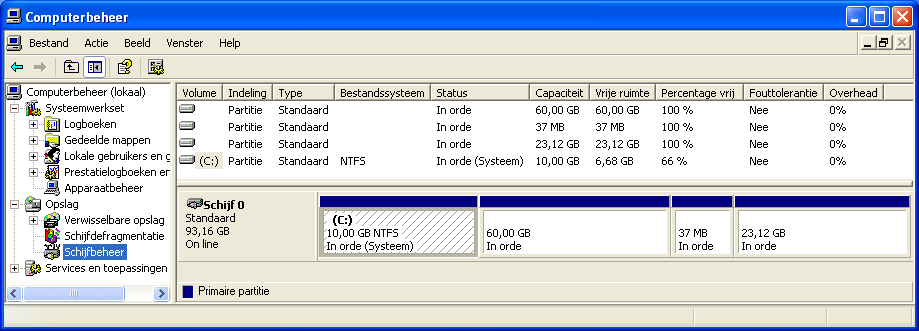

All partitions have to be created in the right order because they are counted in order of creation.
Windows can only be installed in a primary partition.
If you use XP then all your partitions have to follow the CHS partition scheme which causes alignment to the cylinders.
In other words, if the partitions are created by the XP installer or by XP's disk management then they will be fine.
If you use the XP installer to create a second partition then you risk that it will be a logical partition in an extended partition.
Thus create only one partition.
Then I started over.
I used Partition Magic to remove the partition table by creating a new "msdos" partition table.
I ran the XP installer.
I created one partition of 10 GB and formatted it as NTFS.
I installed XP here.

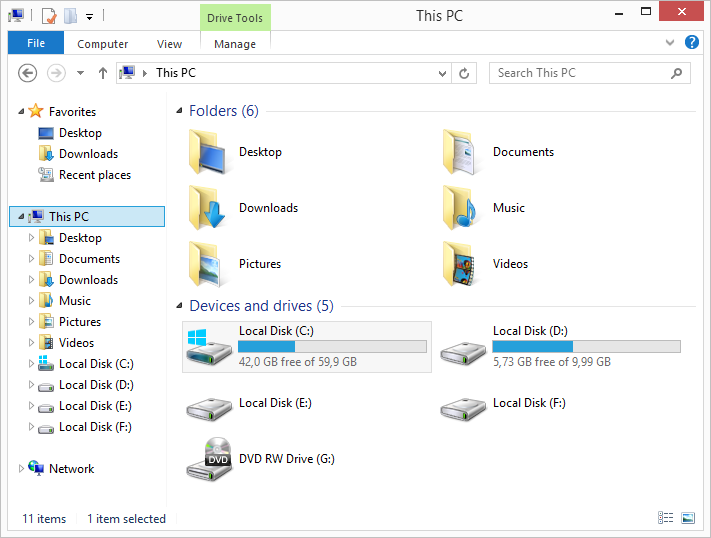

The first time XP started I went to disk management to create primary partitions of 60 GB, 37 MB and 23.12 GB.
I did this without assigning a drive letter and without formatting.
60 GB is for Windows 8.
37 MB is for an EFI partition for Ubuntu.
23.12 GB is for Ubuntu.
I ran the W8 installer.
I formatted the partition of 60 GB (NTFS is chosen automatically).
I installed W8 here.
When I restarted I had a boot menu that looks a bit more pleasant compared to the plain terminal multi boot menu of XP.
I chose to start W8.
It showed a block with W8 and a block with "Older versions of Windows".
I clicked on the blocks until "Older versions of Windows" was set as a default.
I thought that this would prevent it from disappearing from the menu like it did last time.
Then I clicked the block with W8.
From then on it worked like you would expect.
Just one difference:
In XP I see only "C".
In W8 "C" is called "D", while the W8 partition is now called "C".

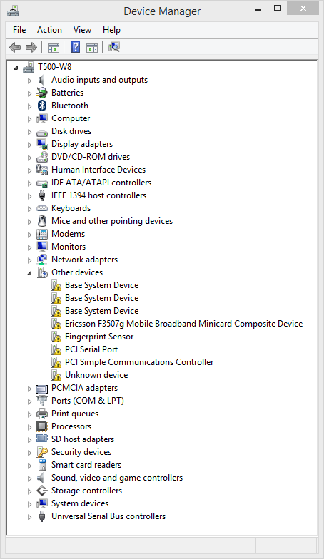

Now I have uninstalled devices in W8:
In the same order:
ACPI\IBM0068

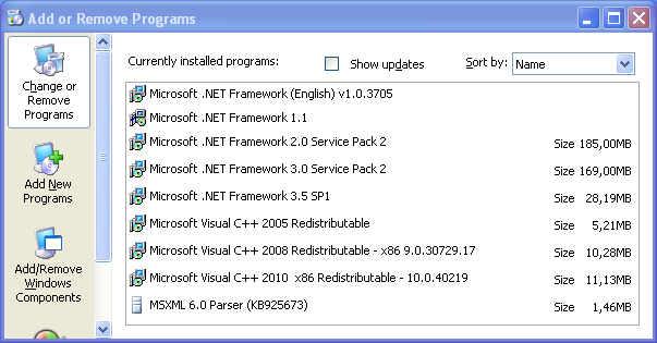

I installed English XP SP3 x86.
I installed the frameworks.
I had 16 uninstalled devices.

In Windows 8.1 the following devices are not installed:
Base system devices:
Ericsson F3507g Mobile Broadband Minicard Composite Device:
USB\VID_0BDB&PID_1900&REV_0000
Fingerprint Sensor:
USB\VID_08FF&PID_2810&REV_1703
PCI Serial Port:
PCI\VEN_8086&DEV_2A47&REV_07
PCI Simple Communications Controller:
Unknown device:
Another problem: I don’t have the correct screen resolution.
I haven’t installed a thing yet in W8.

NET 4.0 could be installed in XP SP3.
I installed in Windows 8:
- Ericsson wireless module = Vodafone and AT&T wireless WAN (HSPA) driver 1.0.1046.229 = folder WWANER = 7uwc49ww.exe
- Lenovo power management driver 1.67.4.4 = folder PMDriver = gtku07ww.exe
- Ricoh 4-in-1 card reader driver for Windows Vista&XP = folder 4IN1 = 7kss55ww.exe
- Synaptics ThinkPad UltraNav driver 16.2.19.2 = folder UNAV = 6hgx73ww.exe
- ThinkPad Lenovo mobile broadband for Windows XP&Vista 3.4.71 = folder 7twa71ww = 7twa71ww.exe
- ThinkPad modem adapter software 7.80.8.50 = folder ModemOM = 6imb06ww.exe
There are 3 devices left + the Radeon + IMSM/AHCI.
Fingerprint Sensor:
The 2 pieces of AMT:
PCI Serial Port:
Summary:
- AMT.
- Fingerprint sensor.
- IMSM/AHCI.
- Mobility Radeon 3650 HD.

The following parts could not be installed in Windows 8.1:
- Intel AMT 4.2 local manageability service and serial over LAN driver 5.4.1.1016 = 7vr408ww.exe
- Intel AMT 4.2 management engine interface for Windows 4.2.0.1008 = 7vr308ww.exe
But they could be installed in Windows 10 in Windows 7 compatibility mode.
